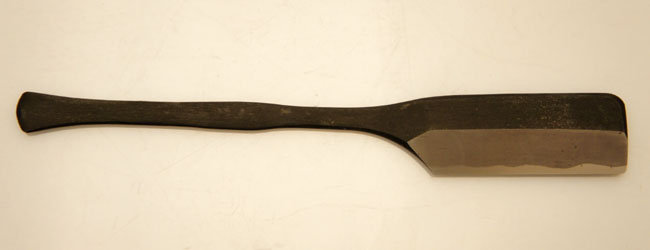

Takami 52mm Double bevel edges Watetsu
MessagePosté le: Sam 30 Nov - 13:42 (2013)    Sujet du message: Takami 52mm Double bevel edges Watetsu Répondre en citant

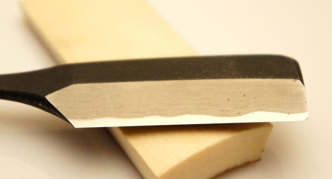

It has no concaves (hollow ground) on the both sides of the blade. The both sides of bevels fit on the whetstone very well, when we sharpen it.
Watetsu is the iron that is produced with Tamahagane, when Tamahagane (approximately 0.8% to 1.5% carbon content) is made in the steel manufacture, however Watetsu is approximately 0.1% of carbon content, so it cannot use it for blade edge as steel (Hagane) . However, Watetsu is used as one of the best Jigane (soft iron), because it is very soft, and easy to sharpen, and feel excellent when we sharpen the blade, and it has flexibility. Japanese carpentry blacksmiths who make high quality chisel or plane use Watetsu for their cutlery Jigane often. There are some points what it is hard to use Watetsu: To get Watetsu are two ways to get it. One is make own Tamahagane, and the other is to find more than 150 years old steel products like 100 years old high quality hardware made by Tatara steel manufacture (a part of Tamahagane). In Samurai era, Japanese steel products had been mostly Tatara steel manufacture.
Watetsu is made out of charcoal and iron sand, and it is not homogenized.
Selecting high quality portions, and putting together, and It has to turn over many times the Watetsu to be homogenized, and remove unwanted part of steel in Watetsu by sorting with turning over and cutting off the unwanted parts. It costs so many times more than just using ordinary Nantetsu from steel company. After all the process of making Watetsu, sometimes, all of Watetsu product cannot use it, or it might be 50% usable, or it might be usable 100%. We do not know until cut off the size of one cutlery needed, but actually we do not know until the cutlery product to be done.
However , the Jigane by Watetsu looks natural Damascus, because it is turned over so many times many different mixture of steel parts. It also shows black lines between layers, because it is made from different homogenized steels. It is also easy to sharpen, and it has flexibility.
Even one of the greatest carpentry blacksmith, Chiyozuru, Korehide made Japanese plane Jigane shows black spots, but it looks more beautiful than without it.
The Hagane is Sweden Assab K-120 that some people are called ash Western Tamahaganeh . Jigane derives from 200 years old house hardware.
The total length of razor: 6 3/4h (170mm) The weight of razor is 2.0oz.
The spine side of heel width: 5mm (3/16h) The width of the razor blade: 22mm (7/8h)

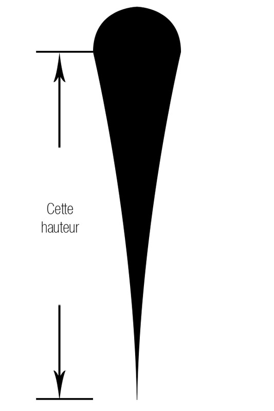

j'avais pas fait gaffe mais il y a un truc qui me turlupiné Very Happy en fait il y a 2 faces Ura ? tu peux dire environ l'épaisseur le la lame et les hauteurs d'émouture ? j'ai l'impression que l'angle est énorme sur ce rasoir, si ça tire malgrè un fil super poli, c'est que l'angle est trop gros et faut remonter l'émouture.

tu mesures comment Kyoshiroo ? faut prendre l'arrête du haut de l'émouture et pas la largeur de la lame.
Furax, 28°, t'auras jamais un bon rasage avec ça, faut remonter l'émouture, si tu veux garder ce rasoir, je peux te le faire

J'ai pas compris la chose avec l'arête de l'émouture. Sur le tiens l'arrête est le dos sont quasiment au même point. Mais tu veux dire sur un rasoir avec un dos bombé par exemple, je dois diviser la largeur du dos par la distance allant du fil au haut de l'émouture ?
Si c'est ça mon rasoir qui ne rase pas bien aurait un angle encore supérieur. Shocked
MessagePosté le: Dim 29 Déc - 16:05 (2013)    Sujet du message: Takami 52mm Double bevel edges Watetsu Répondre en citant
Oui, c'est seulement les points de contact sur la pierre qu'il faut prendre en compte.

Ali te parlait de cette hauteur :
